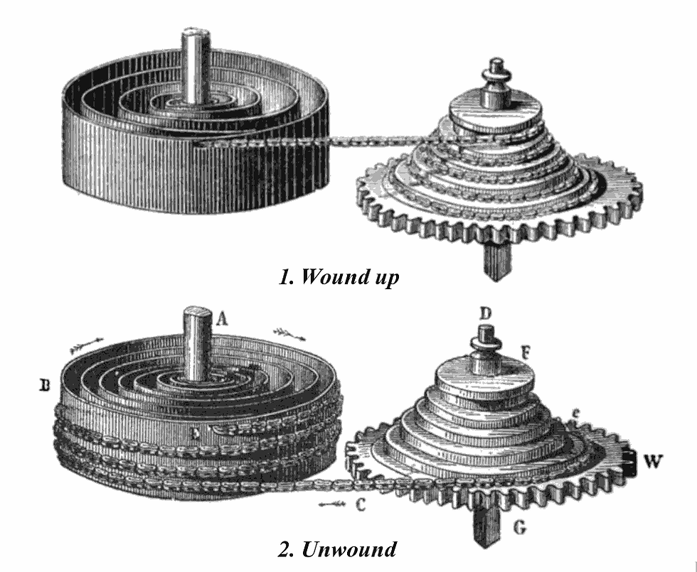

Enter the Fusee
Later verge clocks were generally accurate with pendulums that provided consistent power, but verge pocket watches required something to compensate for mainsprings that lost power when unwinding. The fusee was the answer for most spring-driven timekeepers, either watches or small clocks. It was a cone-shaped wheel with a chain or cord that connected directly to the mainspring, compensating for the change in power (not unlike changing gears on a bicycle when your legs tire). As the mainspring unwound, it pulled on wider and wider parts of the fusee as it unwound, adding additional turning force from the weaker spring. A ratcheting mechanism prevented the fusee from rotating backwards and its shape almost perfectly matched the power fluctuations. This helped solve the verge escapement’s shortcomings for centuries.

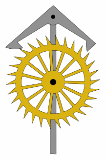

Anchor Escapement
While the verge escapement was standard for many pocket watches into the 19th century, the anchor escapement became favored for clocks as early as the late 17th century. The escape wheel and pallet fork became vertical, streamlining the design and allowing for reduced swing angles of the pendulum. This greatly increased accuracy and reliability, and led to the addition of a minute hand. Before the anchor escapement, most clocks just had an hour hand as accuracy wasn’t reliable enough for minutes.
The flat anchor escape wheel had long, backward leaning teeth that engaged with the anchor above (pallet fork), which moved back and forth via the pendulum to lock and unlock from the teeth, one at a time. It wasn’t perfect and still had friction and wear issues, but was a big step forward from the verge escapement. An improved version, known as the deadbeat escapement, had curved ends on the anchor that helped prevent recoil and a slight backward push of the escape wheel as the teeth engaged. This type is still used today in pendulum clocks.

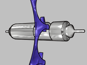

Cylinder Escapement
Clocks were generally established at this point with the anchor escapement and refined variants, but the next major advancement for pocket watches was the cylinder escapement. It was invented in 1695, but reworked into a finished product in 1726 by English clockmaker George Graham. This was the escapement that often replaced the verge type in pocket watches and was much thinner for more streamlined cases. Unfortunately, it wore out quickly, so the English somewhat abandoned the new design, but French watchmakers all but solved the problem. By making the cylinder and escape wheel from hardened steel, the movement was not only more robust, but cheap to produce.
It's called the cylinder escapement as the traditional pallet fork was replaced by a cylinder with cutouts to engage the escape wheel teeth. Although cheaper and relatively accurate, the escape wheel made longer contact with the cylinder, so there was increased friction and consequently wear, and more frequent maintenance was required. It was a major improvement over the clunky verge escapement, but more work was needed.
